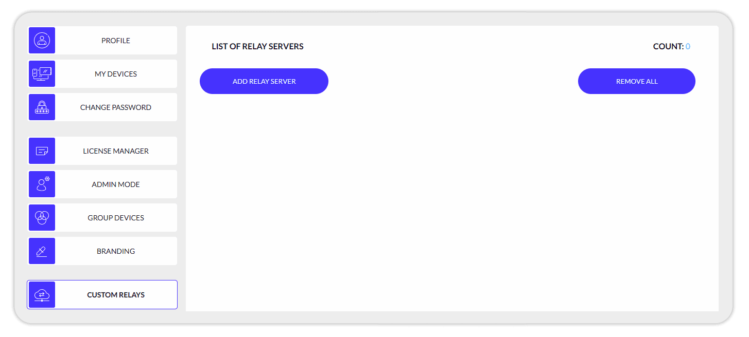

3. Registering the relay
Log in to your account at remotly.com, go to CUSTOM RELAYS
panel
Click Add relay server and provide:
- IP address of your relay server
- Port(s) from RelayGoConfig.json
- Device name that will be visible in Remotly PC or mobile app
- Country code for this relay
- Password (mandatory to be the same as set in RelayGoConfig.json)
add relay
Once configured, when connecting to another computer with Remotly and Force Connect Anywhere enabled, you should see only the country code and name of your private relay server.
